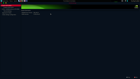

Hello Parrot OS Community,
I’m using Parrot OS 6.3 on a laptop with hybrid graphics (Intel + NVIDIA GTX 1050). After installing the NVIDIA driver using:
sudo apt install nvidia-driver -y
I noticed that my HDMI port stopped working — my second monitor is no longer detected.

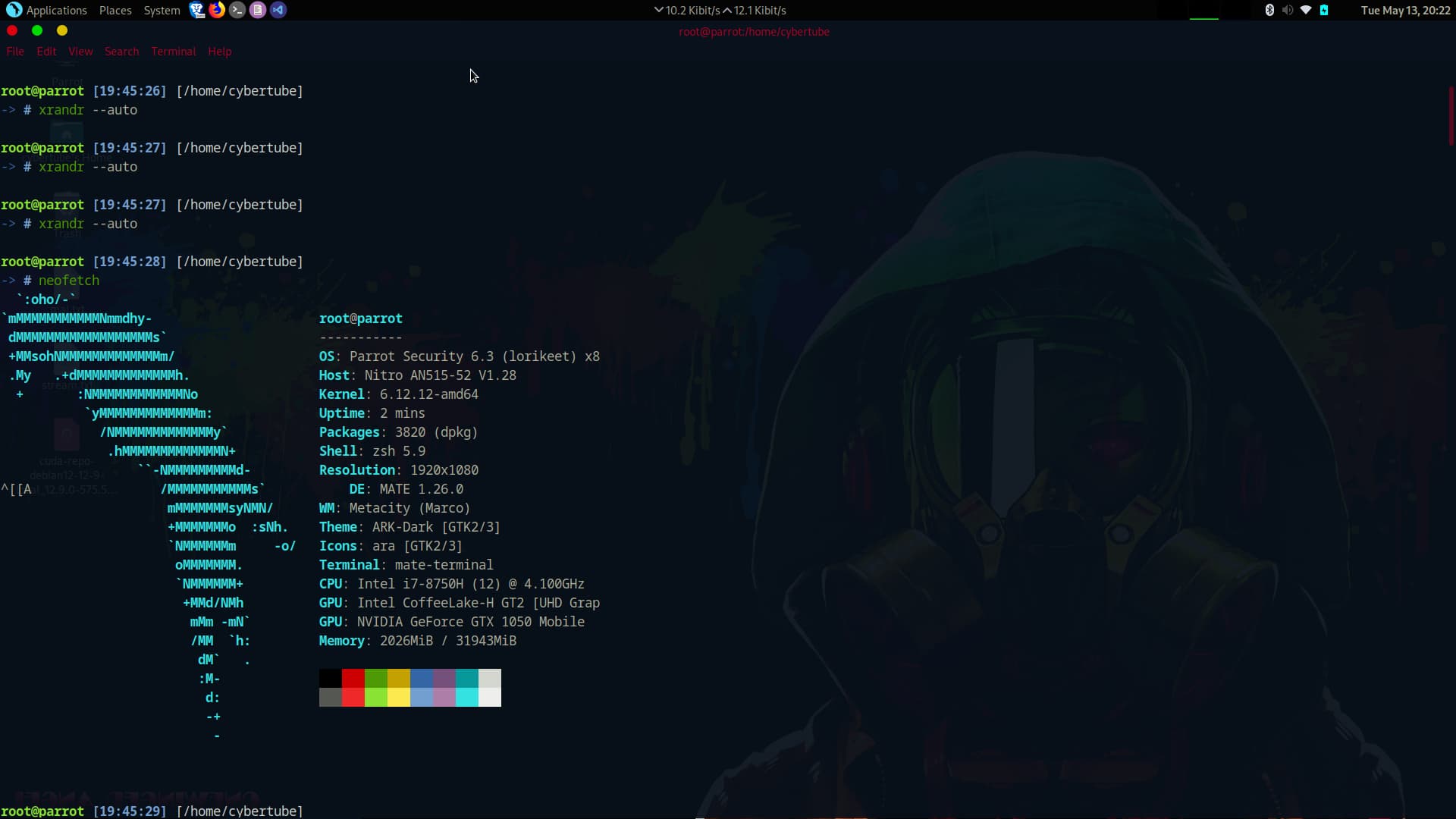

This is a common issue with laptops, for two monitors you usually have to use the discrete GPU and not the inbuilt GPU which is typically used for power saving not performance.
One thing to try first though is to set up the monitors with xrandr (this is just an example, change options to suit your set up);
xrandr --output HDMI-0 --auto --output HDMI-1 --left-of HDMI-0 --auto
you will probably need to reboot to see the changes.

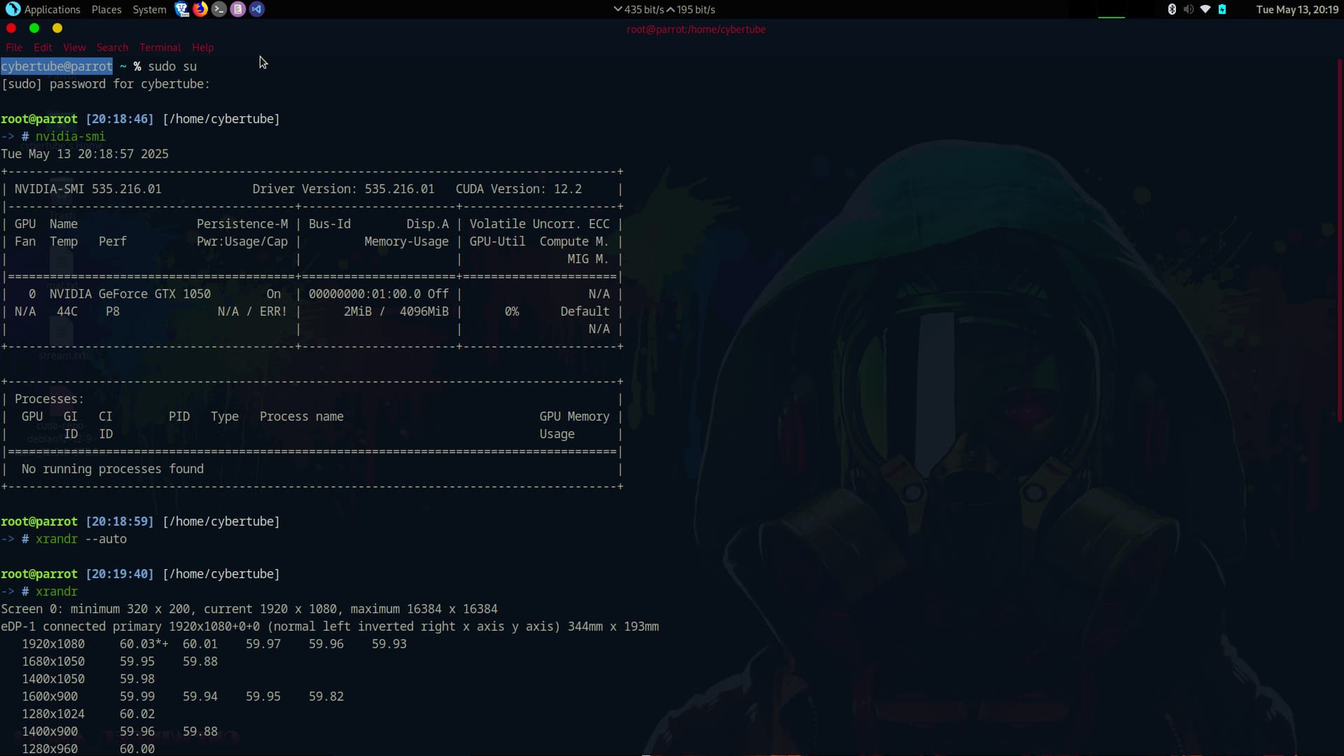

Hi, I’m facing the same problem:
01:00.0 VGA compatible controller: NVIDIA Corporation TU117M (rev a1)
05:00.0 VGA compatible controller: Advanced Micro Devices, Inc. [AMD/ATI] Renoir (rev c6)
After installing nvidia-drivers the hdmi monitor disappeared. I’ve spent many hours to make both external monitor and laptop display to work, but no way. The only shitty workaround I found is to use them alternatively.
To use hdmi monitor with nvidia create a new conf:
sudo nano /etc/X11/xorg.conf.d/10-nvidia.conf
Section “Device”
Identifier “NVIDIA Card”
Driver “nvidia”
BusID “PCI:1:0:0” # Replace with your GPU’s BusID (from `lspci | >
Option “AllowEmptyInitialConfiguration” “true”
EndSection
save and reboot.
To use just the laptop (with amdgpu in my case) rename the file:
sudo mv /etc/X11/xorg.conf.d/10-nvidia.conf /etc/X11/xorg.conf.d/10-nvidia.conf.bak
sudo reboot

but xrander finds gust AMD:
xrandr --listproviders
Providers: number : 1
Provider 0: id: 0x53 cap: 0xf, Source Output, Sink Output, Source Offload, Sink Offload crtcs: 4 outputs: 1 associated providers: 0 name:AMD Radeon Graphics @ pci:0000:05:00.0
so I cannot execut the suggested:
xrandr --setprovideroutputsource NVIDIA-0 modesetting && xrandr --auto
and only eDP is usable in this case
