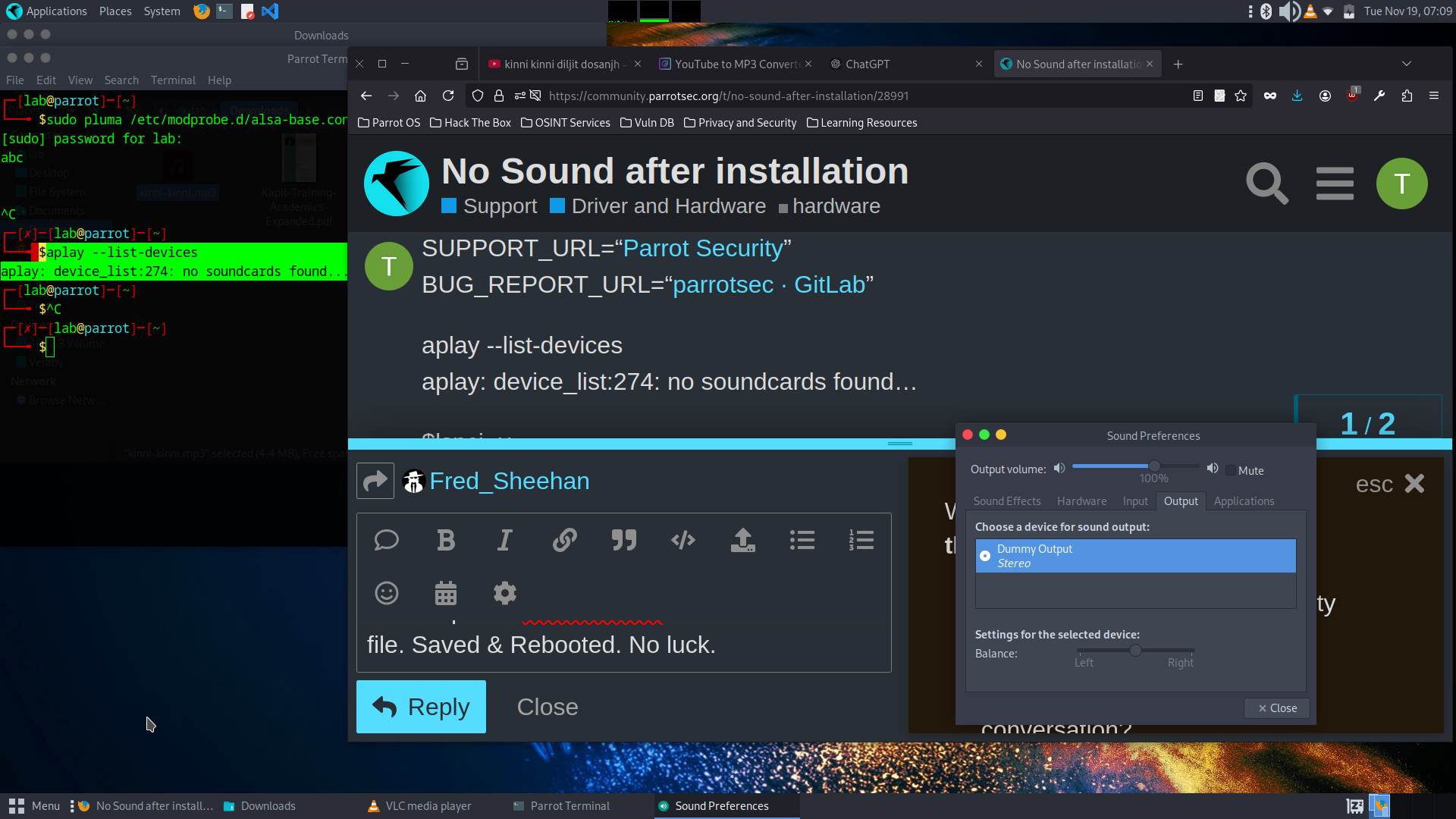

No Sound after installation
I am getting no sound on my fresh install of Parrot. It seems the card is not being detected at all. I am attaching the outputs of various troubleshooting commands. Any help is appreciated.

aplay --list-devices
aplay: device_list:274: no soundcards found…

  • Parrot version in use (if you are not aware of it, open terminal and type cat /etc/os-release | grep VERSION):
  • Kernel version (if you are not aware of it, open terminal and type uname -r):
  • Logs/Terminal output (use pastebin or similar services):
It is seeing your sound device;
00:1f.3 Multimedia audio controller: Intel Corporation Tiger Lake-LP Smart Sound Technology Audio Controller (rev 20)
Subsystem: Hewlett-Packard Company Tiger Lake-LP Smart Sound Technology Audio Controller
Flags: bus master, fast devsel, latency 64, IRQ 16, IOMMU group 14
Memory at 6003248000 (64-bit, non-prefetchable) [size=16K]
Memory at 6003000000 (64-bit, non-prefetchable) [size=1M]
Capabilities:
Kernel driver in use: sof-audio-pci-intel-tgl
Kernel modules: snd_hda_intel, snd_soc_avs, snd_sof_pci_intel_tgl
So you just need to make sure its correct kernel module is being switched on at boot time. Try changing the alsa config file;
sudo pluma /etc/modprobe.d/alsa-base.conf
And adding;
options snd-hda-intel model=auto
save and reboot and it should work as expected.
Thanks Fred. I did try the adding the line in there “options snd-hda-intel model=auto” to the file. Saved & Rebooted. No luck.
Attaching the response of aplay again :
└──╼ $aplay --list-devices
SS of the SOUND PROGRAM :
You might need firmware loaded;
https://forums.debian.net/viewtopic.php?t=153813
FIXED IT : Appropriate FIRMWARE was the issue here.
